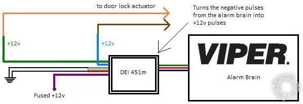

Okay, I must start off by saying thanks to the 12volt community. There is some much helpful info and people on here. I am in need of a little more help and I hope someone can shed some light as I am installing my first R/S with aftermarket actuators.
   I have 2 dei 524t actuators which only has 2 wire each, green and blue. I got a dei 451m to help install these, but i am a little bit confused with the 451m. Is this the way i should hook up everything?
dei 524t to dei 451m to viper 5901 -- posted image.
Posted: May 03, 2010 at 5:17 AM / IP Logged
Yes and unless you're reversing the actuator travel, GREEN/ black to green on motor and blue/black to blue on motor.
