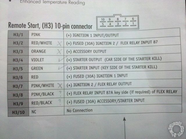

viper 5902 remote start problem -- posted image.
Here is how I've wired the H3 Harness...
h3/1 - ignition
h3/2 - constant 12v
h3/3 - accessory
h3/4 - starter output (car side of starter kill)
h3/5 - starter input (key side of starter kill)
h3/6 - constant 12v
h3/7 - constant 12v
h3/8 - not used
h3/9 - constant 12v
h3/10 - n/a
lee0092
Member - Posts: 13
Joined: May 21, 2010
Posted: May 21, 2010 at 10:13 AM / IP Logged
Some more info..
I've tested all the wires with a circuit tester pen and all wires work, except the violet H3/4. Even when I attempt to start the car with key there is no power coming from that wire. I have checked the H3/5 Green starter input wire and there is power as I try to start the car. Just no power coming from H3/4 to the starter...???... Could it be the brain that is the problem???

H3/7 should not get 12v it goes to the 2nd access or ignition if applicable to your vehicle.  h3/2 powers it and your diagram states you have it to 12v.  is the alarmed armed when you try to start the car with the key or disarmed?

H3/7 should not have a constant 12volt try connection with the H3/1. H3/9 can also be the input to the starter

Okay... I have now connected H3/7 with H3/1 and I'm now getting "Invalide Pulse Count"  on the remote when I try to remote start... Also I don't see why H3/9 should be connected to the starter input?? Though I did test it out and there is no results...
Overall it's still the same, the Violet (Starter Output) still have no power... ??? Help???

help please!? viper 5902 remote start problem -- posted image.

Can you list the color of the wires you tapped into?
Should be
h3/1 (Pink) - BLACK / YELLOW
h3/2 (RED / white) - constant 12v
h3/3 (orange) - Yellow
h3/4(violet) - BLACK/ White Car Side
h3/5 (green)- Black White Key Side
h3/6 (red)- constant 12v
h3/7 (pink/white) - constant 12v
h3/8 (pink/black)- not used
h3/9 (RED / black)- constant 12v
h3/10 - n/a

I wrote the H3/7 wrong use it as previously stated
tegguy
Copper - Posts: 155
Joined: December 21, 2009
Posted: May 23, 2010 at 8:50 PM / IP Logged
Also Orange H3/3 is not used
