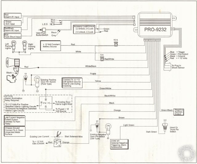

Posted: June 02, 2010 at 1:59 AM / IP Logged
alarm needs to be reset -- posted image. Hopefully this posts.. it is a diagram of the alarm schematics. Top center is the wiring for lock/unlock connections. You'll just have to find these wires and check what kind of door circuits you have..whether negative or positive pulses. A relay may be needed and maybe not.
