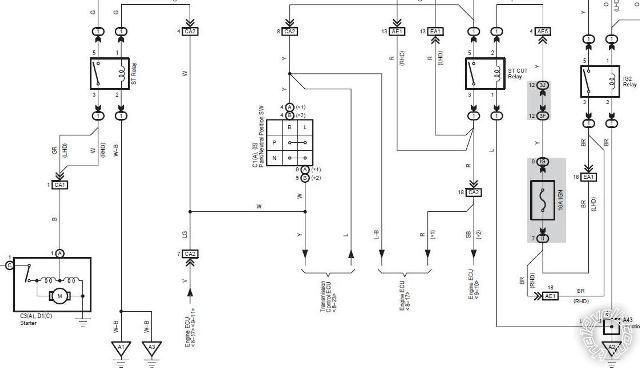

But i'm afraid. When the coil of Ignition 2 Relay energized, the Starter Cut Relay will trigger. Thus make the starter motor to stop.
Am I right? See this wiring diagram
ignition 2 function -- posted image.

You've made the basic amateur mistake of over analysing/over complicating. With a remote start these leads are picked up at the ignition switch well before the relays shown in this frankly unreadable diagramme.
Keep it simple, obey the post rules and tell us make, model and exactly what your query is.

"unreadable diagramme" maybe, but I like that it shows the centre-tapped starter solenoid (hence why the take say 20A with the heavy battery terminal (C, to the battery) connected, but double that (40A) when not. That can cause problems for those that only have starter switches or relays that don't handle the higher current (40 Amps through a key switch - not good!).
And it shows relays the way I like to see them - ie, functional, not physical.
Of course I've taken the liberty of interpreting unreadable diagramme as being its style - not its dithered text.
Otherwise I'd have nothing to write other than "x2" (ie - what howiell wrote.
(I miss my old 1-page vehicle electrics!)

this diagram described electrical wiring diagram on ignition system for Toyota Camry 2009 . sorry becoz this diagram quite blurred.
ok. my question, during remote start for Camry 2009 (auto):
a) do I need to connect ignition 2 wires ..and the reason?
b) which relay will work to stop the starter motor (centre-tapped starter)?
during ignition, max. current can increase up to 30A
