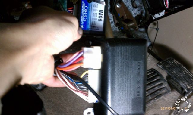

hi again, finally got around to getting back into this. still having an issue finding any kind of switch as you've referred to. i took a pic of my head unit, and the omega integrator that was installed. I would have to assume, even if buried somewhere, this switch is in the correct position, because i used my remote start up until the remote crapped out before Xmas. as a coincidence, i got a spare key programmed the same week. once programmed, the OEM key fob unlocks the doors, where the original key did not, this task was performed with the code alarm remote.. Not sure if this is any hint? again, i really appreciate this help, maybe my pics will help a little..program new remote, code alarm -- posted image.

Programming a new Code Alarm remote has nothing to do with your factory key fob and it has nothing to do with the PKT2 and IM05.
The red handled switch that lectricguy is talking about is also called the valet switch. Code Alarm systems use a red button valet switch. Did you install this system or not? If you didnt, its possible that the installer didnt install the red button valet switch.....it could be black instead. Sometimes you will see this valet switch mounted in the kick panel or somewhere under the dash. Look at the Code Alarm brain. See if there is a 2 pin blue connector port. The valet switch should be conncted to it. If there isnt anything plugged into the blue port , you will need to get a valet switch.

  I agree with godd dan it, that sometimes installers don't install the switches in an obvious spot...sometimes they are taped or ty-wraped to the wiring under the dash or in the fuse panel.  In the CA500, there are 2 switches; a safety switch (usually a toggle--code supplies a red handled switch) to disable the Remote Start functions, but allows convenience features such as locks and trunk release to still operate--and a push button switch for programming.(momentary switch) .
  Note the the safety switch provides a connection to ground when "on", and an installer may have skipped the switch and tied this wire directly to ground.
  If you refer to the install manual (I sent the link in a previous post), you can see where these switches connect to the brain.   In your picture from your last post, notice the12 position connector on the lower left, where there is a BLACK/ white stripe wire--5th up from the bottom as seen in the photo.  This wire goes to the safety switch.  Just follow that wire, and you will see the switch or the ground connection.
  As far as the program switch,  The end on the very bottom of your photo is where this switch connects to the brain--we can't see this from the photo as it is cut off.  There should be a 2 pin blue plug for this switch--Again refer to the install guide--from the bottom right refering to your photo, going right to left, there should be the antenna cable (3 wire black cable), Door locks (2 wire blue and green) and then the program switch--Usually a grey and black cable with a blue connector.
This blue connector is the connector you need to use, preferably with a momentary switch.  Also note that in order to get into programming mode, the key needs to be in the ON position--this provides IGN power to the remote start, a requirement to get into programming while you are pressing the program switch (or jumping the leads of the blue connector).
