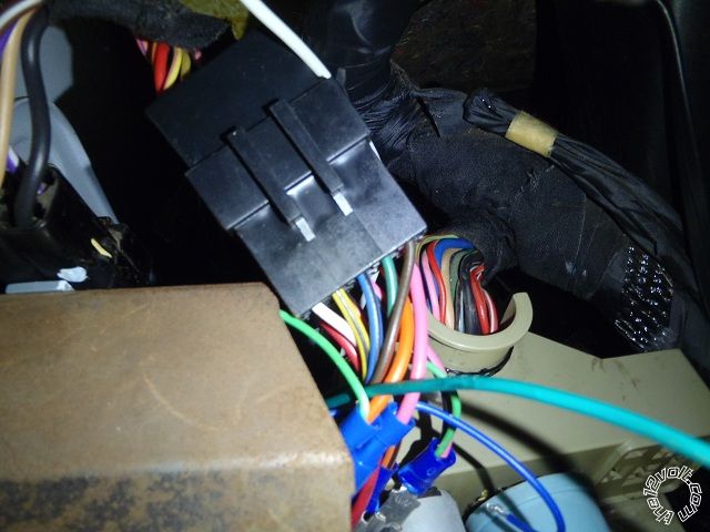

I'm installing a python 991 lc3 system in my 92 dodge dakota. for the power door locks this is the harness
power door locks on dodge dakota -- posted image.
i found a wiring diagram that says it is a 5 wire reverse polarity. i'm pretty sure i'll have to use relays but i'm not sure which relay diagram to use. any help would be appreciated.

Here is wire color info from Bulldog Security :
 POWER LOCK        ORANGE / VIOLET (TYPE C)   IN DRIVERS KICK PANEL, BLACK plug behind FUSEBOX
 POWER UNLOCK  PINK/VIOLET (TYPE C)          IN DRIVERS KICK PANEL, BLACK plug behind FUSEBOX
Here is link to relay diagram :
https://www.the12volt.com/doorlocks/page3.asp#5w

thanks for the reply, i bought the 451m relay module from direct electronics wiring the locks according to the diagram and everything is working fine, it took me a minute to find the wires i needed since they were covered in tape, but other than that everything went fine, thanks again
