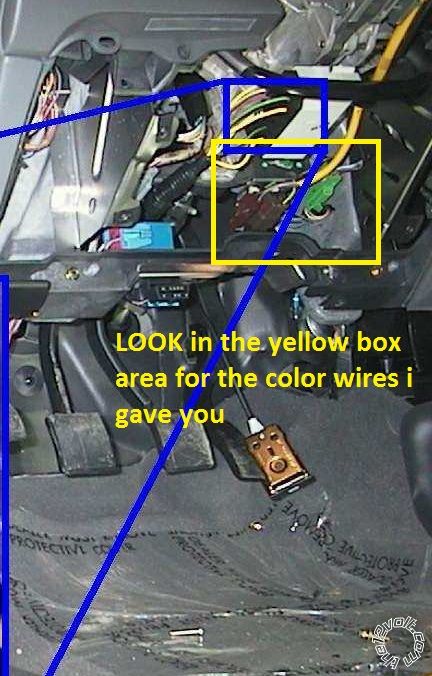

no they should becoming from the immobilizer you can usually find them near the bottom of the steering column or near the immobilizer plug by the ignition switch(tumbler)
the connector if the color don't make it pin 4 and pin 3 there should be 4 wire in the plug total

Here is a pic that might help my guess it will be the green plug
2004 ford ranger remote start xk05 -- posted image.

hahaha i was trying to find a pic like this and post it to show you but then i read that rookie members cant post pics...lol...i will look for those wires tomorrow...thank you soo much!!
