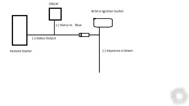

Probably not.  Keysense is required to keep Service Required light from coming on.  A standard 1N4001 diode
( available from RadioShack ) is soldered in line with the Status Out wire going to the cars Keysense wire.
See diagram :
remote starter in 05 equinox -- posted image.

Thanks for the diagram. I know the orange one is powered but i cant remember if the brown is. Ill have to check again to double check. Do you think the 556lw is faulty since i cant get it to program?
