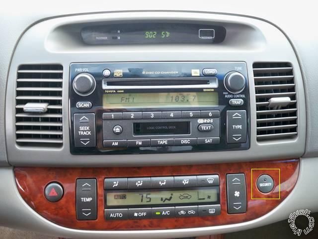

Not all Camry's have a transponder from that generation. I think only the 6 cylinder engines and maybe the SLE trim have them... There would be a security light flashing and would it would stop flashing as soon as you stuck the key in the ignition but not turn it. The security light is in the bottom right of the picture. I put a yellow box around it to point it out.

If an all steel key starts the car than it does not need a transponderbypass module.  Although most web sites list this vehical as having a transponder key some do not. I have come acrosse a few 06 and 07 toyotas that do not have the security key.

If there's no transponder ring over the ignition, then there's no immobilizer
