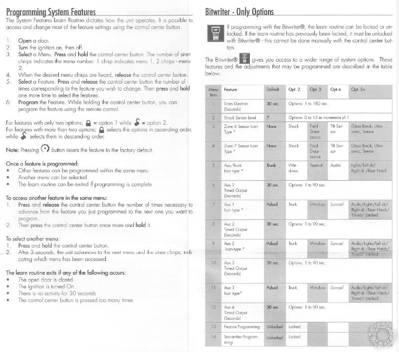

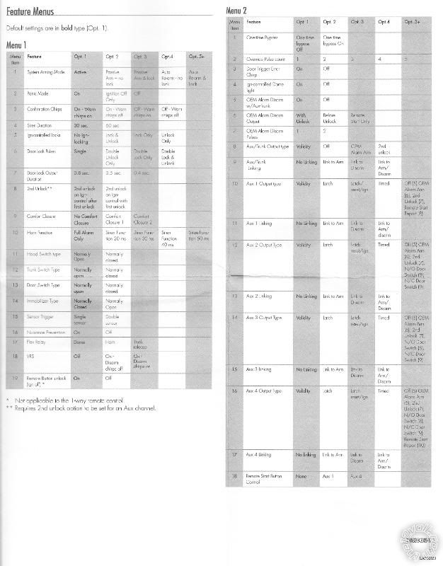

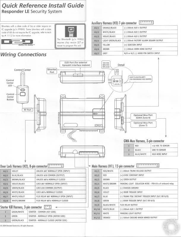

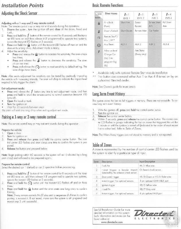

Here is the installation manual for Viper 3203
Viper 3203 Installation Manual -- posted image.

Wiring Connections
H1/1     RED / WHITE     (-)200mA AUX/TRUNK OUTPUT
H1/2     RED     (+)12VDC CONSTANT INPUT
H1/3     BROWN     (+) SIREN OUTPUT
H1/4     WHITE/ BROWN     PARKING LIGHT ISOLATION WIRE - PIN 87a of onboard relay
H1/5     BLACK     (-) CHASSIS GROUND
H1/6     VIOLET     (+) DOOR TRIGGER INPUT
H1/7     BLUE     (-) TRUNK PIN/ INSTANT TRIGGER INPUT (N/C OR N/O)
H1/8     GREEN     (-) DOOR TRIGGER INPUT (N/C* OR N/O)
H1/9     BLACK/ WHITE     (-) 200mA DOME LIGHT SUPERVISION/FLEX RELAY (Programmable) OUTPUT
H1/10     WHITE/ BLUE     200 mA AUX 1 OUTPUT
H1/11     WHITE     PARKING LIGHT OUTPUT
H1/12     ORANGE     (-) 500mA GROUND WHEN ARMED OUTPUT
*When using the normally closed setting, this wire only covers one door. Use auxiliary outputs 2, 3 or 4 (as necessary) programmed as N/C door switch inputs (wired to each individual door of the vehicle) to cover the other doors. The auxiliary outputs are also programmable as N/O door switch inputs so you can connect multiple doors without the use of diodes.
When the auxiliaries are programmed for these types of circuits and connected to the vehicle, the alarm reports a door violation when triggered.

H2/1     VIOLET*     UNLOCK #87 NORMALLY OPEN (INPUT)
H2/2     BLUE/BLACK     UNLOCK #30 COMMON (OUTPUT)
H2/3     BROWN / BLACK     UNLOCK #87a NORMALLY CLOSED
H2/4     VIOLET/BLACK*     LOCK #87 NORMALLY OPEN (INPUT)
H2/5     GREEN/ BLACK     LOCK #30 COMMON (OUTPUT)
H2/6     WHITE/ BLACK     LOCK #87a NORMALLY CLOSED
H2/7     WHITE/ VIOLET     FLEX RELAY #87 NORMALLY OPEN (INPUT)**
H2/8     WHITE/ BROWN     FLEX RELAY #87a NORMALLY CLOSED**
Posted: July 26, 2012 at 9:51 AM / IP Logged
Last post:-
Violet and violet/black fused 15amps.
Blue/black unlock motor wire, motor side.
BROWN / black unlock motor wire, switch side.
GREEN/ black lock motor wire, motor side.
WHITE/ black lock motor switch side.
