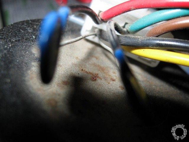

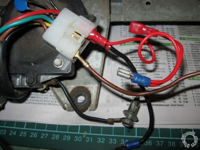

Pic of VS wiper motor's plug/Brown 12V, Red low 12v, Blue high 12v, Black earth and yellow park 12v...

OK for your future reference, at the wiper motor you will generally have the following....
12Volt ignition which feeds the "parking the blades" part when you turn off.
Speed one going through a resistor*.
Speed two going directly to the motor.*
* Speed one goes through the resistor and slows the motor, speed two gives it 12 volts so it runs faster.
Intermittent is usually applied via a chip controlled timer such that speed one instead of working constantly gets its voltage between once per second to once per minute.
Sometimes the feeds at the stalks are negative, e.g. Hondas and VWs this goes either directly to the motor which has a constant feed, i.e. earth or ground switching which is what Oldspark was telling you or in the case of VWs goes to a processor converting the neg switching two pos. and reducing the voltage instead of using a resistor at the wiper motor, more efficient and more expensive.
Some vehicles have a third speed but this is simply adding another resistor etc.
Ever have a train set wit ha speed controller or a Scalextric as a kid? It's the same principle.
