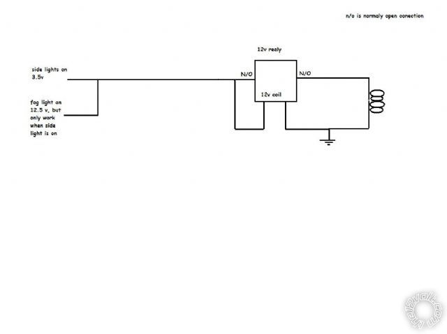

Posted: February 18, 2011 at 2:38 AM / IP Logged
12v relay buzzing at 3v - Page 2 -- posted image.
There doesn't have to be a relay in the circuit if there is another of doing it Im just using at the moment to keep them work.
The leds are standard lights from the manufacture and have a working voltage of 5v to 1.5 volts
I hope this help as i need to sort this prob out pretty soon
thanks for your help
Posted: February 18, 2011 at 4:12 AM / IP Logged
The relay wiring doesn't look right, give us the terminal connection numbers.

Posted: February 18, 2011 at 4:38 AM / IP Logged
The wiring to the relay is right because it works
All I've none is pick the feed to the relay from the fog light switch wire which has 3.5v on it when the side lights are on and then jumps to 12v when press the fog switch
oldspark
Gold - Posts: 4,913
Joined: November 03, 2008
Posted: February 18, 2011 at 5:14 AM / IP Logged
Phew - it works!
My apologies, I thought you were still having problems.
Otherwise I'd question the commoning of 12.5V & 3.5V, and especially 30 & 86 (NO-in & coil).
You did put the diode(s) between 30 & 86? Sorry - that is now irrelevant.
