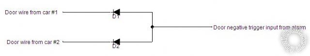

Green NOT purple ((-)Door trigger) to lt grn/blk & lt blue of car
Note: The lt. GREEN/ black is located in the drivers kick and catches only the drivers door. The lt. blue is located in the harness coming from the drivers running board going under the drivers seat and it catches all other doors. Use both door trigger wires and diode isolate each.
crimestopper cs 2003 dc in 98 malibu -- posted image.
