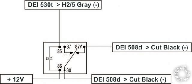

Seems that I need to install a relay on the DEI 508d because it's been trigger by the windows. If I roll up the windows (arm button) the 508d module starts to trigger and a strange thing happens: after I arm the car (with windows UP, no rolling) after 40-50 seconds the car start to chirp (warn-Away trigger), I think it's the dei 508d sensor.
This schematic it's ok ? What should I add to this diagram to prevent drain of battery ? or the relay is energized ONLY when it's triggered by gray wire from DEI 530t.Viper 350, 530t, 2009 Dacia Logan - Page 5 -- posted image.
Posted: May 02, 2011 at 5:02 AM / IP Logged
Yes.

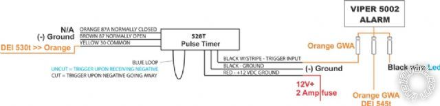

Hi,
I have attached an diagram with DEI 528t Pulse Timer (programmed 3 secs later after the windows roll up) connected to my alarm and DEI 530t windows module. Is it correct ? Another question: I have connected 12V+ red's from all modules (DEI 530t, DEI 545t, DEI 528t and relay for DEI 508d) and alarm at same source input. Should I use separate sources ? I really do not have multiple 12V+ sources under my dash board. I want to know if it's safe.
Posted: May 04, 2011 at 11:26 AM / IP Logged
That's fine as long as they are separately fused.
