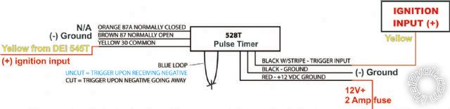

Posted: October 08, 2012 at 11:18 AM / IP Logged
Hello Howie,
I finally got the 528t relay to connect my 545t light module.
I want to delay only the (+) ignition input from my starter to the ignition input wire from the 545t module (to start the lights at an amount of preselected timer 0-60 secs).
I attached an draw to see if it's right
ThanksViper 350, 530t, 2009 Dacia Logan - Page 7 -- posted image.
Posted: October 08, 2012 at 11:24 AM / IP Logged
How not to fry your 545t.
Brown goes to the same source as your RED.
Otherwise when it's triggered the 528t will feed brown (NEG) in YOUR diagram to yellow...oops.
