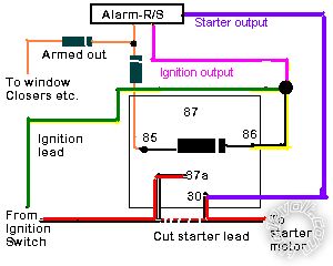

Maybe someone sees the car is starting alone a few times and he 'becames" interesting by stealing it. I want to know if I protect starting the car with the key from bypass. Someone else said to cut the starter wire and wire it through the module as a starter kill, if the power falls out from the RS the he cannot start the engine.
Posted: March 10, 2013 at 3:18 AM / IP Logged
One would have "assumed" that's how you would have done it in the first place.

Yes, i know that but in my case a keyless bypass cannot be done so i want to use the onboard relays from RS as a kill starter, is it possible or should not do this ? can you please tell me how to wire it up ? Thank you in advance.
Posted: March 10, 2013 at 6:53 AM / IP Logged
That diagram will disable remote start whilst alarm is on this one is better:-

Posted: March 10, 2013 at 7:06 AM / IP Logged
I appreciate your help very much, Thank You.

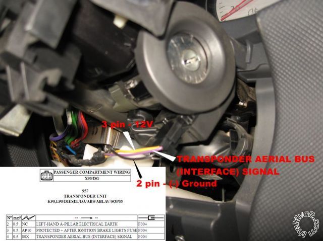

Still not decided what bypass should I use for my RS, I rather prefer a keyless bypass like Xpresskit XK05 with PKTI firmware witch is available for me to buy it from a local store.
The install seller told me that this kind of bypass is compatible with my car and he installed a lot of them for my type of car but he
didn't want to tell me how can I make the connections unless Is installed by them.
So I try to figure out with the installation manual
next to ignition barrel witch wires should I connect but I don't see any plugs like T8 Black or E5 White located at the ignition switch
only transponder plug with 3 wires (12V+, antenna signal from Ignition Immobilizer system and (-) ground). The RX/TX wires are missing.
This wire (pin 4 - Transponder aerial bus interface signal) goes to passenger compartment computer (pin A16 - Black) and then from this unit (at pin B36 - Green) a wire goes to injection computer (gray module - B4)
I want to figure out how RX / TX wires are function it for transponder Ignition Immobilizer and how can I wire them to my transponder.
Here's a picture with my ignition barrel.
Viper 350, 530t, 2009 Dacia Logan - Page 9 -- posted image.
Posted: March 14, 2013 at 6:20 AM / IP Logged
Pay the installer to do it.
I have no info on Renault.
