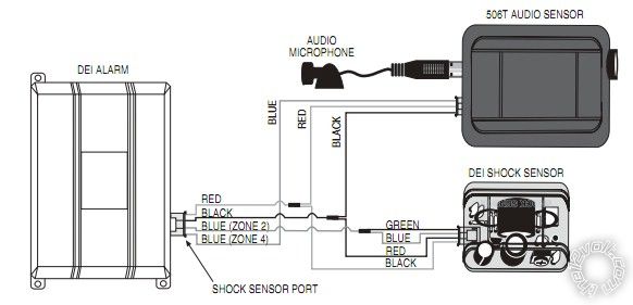

What blue/white wire? It doesn't have one. It does have a WHITE/ blue but that's nothing to do with the topic. Connect the sensor as follows. Black to alarm's orange, red to red blue to blue again as before, diode separation. No problem with your siren configuration.

If you have an externel shock sensor...follow this
avital 3100, 1992 toyota tercel - Page 2 -- posted image.
Howie, I took this from the manual itself, what I find very strange is that the shock sensors black and red are reversed, is this a mis-print?
In this, it doesn't apply, do what Howie described.
