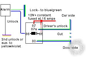

Thanks for the reply. I saw that but i thought in order to preserve the "Priority unlock" feature of the car i would need to use a 5 wire or a reverse polarity setup ?? to connect directly to the motor inputs at the SJB. IN addition to the connections you replied with.
Posted: July 06, 2011 at 7:03 PM / IP Logged
x 2 with Mr. I but if you were thinking of priority unlock look at this diagram:- priority_unlock.bmp
Standard Bosch type 5 pin relay, 1N4004 diode across the coil, cut the driver's unlock as per the diagram. Since you've broken the rules and haven't told us what alarm, I've used black as the second unlock wire. If you don't have a second unlock use an aux.

Posted: July 06, 2011 at 7:16 PM / IP Logged
Thanks, that looks good. Sorry i forgot the alarm model, its a viper 5901. but i understand what wire to connect to on it. Thank you!

Joined: November 28, 2010
Posted: July 06, 2011 at 11:07 PM / IP Logged
OOPS.... disregard the last two messages.... i followed your diagrams and it looks like its going to work.... i will attach the brain tomorrow but they worked by grounding out the alarm inputs so i can't imagine any different result.
