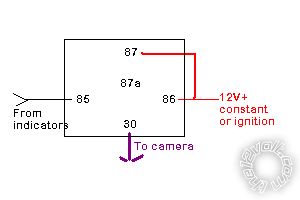

I am installing a 3 camera switcher with rear and side cameras. While I can individually confirm everything is working by applying power to the triggers.. I am having trouble with the side view triggers. (turn signals).   When the vehicle is completely off my turn signals rest at a constant 4V and have a zero volt reading when activated. With the vehicle in the on/acc position my turn signals rest at 13v and have a zero volt reading when activated. I am assuming I need to reverse polarity so that the turn signals will activate the cameras but I need a wiring diagram or help with this. Thank you!
Posted: July 23, 2011 at 11:43 AM / IP Logged
Something is wrong here, they should be zero at rest and 12V+ (nominal) on working. Any way if you're correct you will need this camera.bmp

Thank you for your replies! I have figured this one out for the most part. I installed this on an International truck that's been highly modified. The electronics are all being run off the ISIS Power Multiplexing system. Which I cannot say enough GREAT things about and HIGHLY recommend! I reversed the polarity with one relay from the turn signal output to the camera switch for all cameras.. The only puzzling thing here is when I turn on my turn signals (and the cameras activate perfectly) my rear reverse lights illuminate as well.. :-/
Posted: July 24, 2011 at 1:48 AM / IP Logged
Diode in line with lead to 85, band away from relay?
