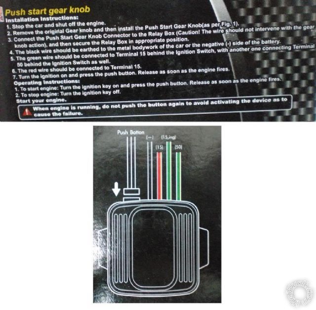

I am instaling a push button starter shift button but the instructions are in foreign terminology as I havent heard of it before I know ground but just need clarification on the other 3, I uploaded this picture on the instructions on the box any help would be appreciated.
terminal 15????, terminal 50?????
black - is ground battery
red -----battery positive ???
green ------15 (battery side of ignition)???
green ----50 ??? what side of ignition
wire 4 wires instructions -- posted image.
Posted: August 05, 2011 at 2:08 PM / IP Logged
15 = Ignition
50 = Starter
