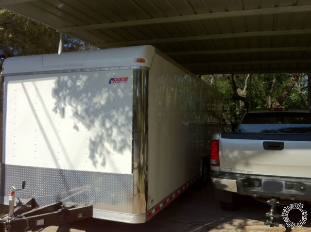

If it helps, below is a pic of the trailer.  Just a big metal box...
python 991 1st lost -- posted image.

A 508d is going to be blocked by the metal body of the unit as will your remote reception range. If you bench tested it the results won't be the same as in a vehicle with glass windows.
You would be better served with just a trigger (pin switch) on the door(s).

Yes, I do plan on using pin switches on the side door and rear ramp/door.  Unfortunately, in my area, it's all too common for this type of trailer to be enetered using an axe or saws-all and going right through the side.  Therefore, I wanted motion inside the trailer.
If I were adding the 508D (motion), 507M (tilt) and 506T (glass break) to the system, do I add all three to the "Optional Mux Port" (using diodes) - thus having all three on the same zone?  Or, is there a way to seperate the zones somehow?  I see no other "inputs" options.  It would be nice to see which one was triggering an alarm - for fine tuning false alarms.

Yes use diodes on the blues and greens, a glass break will be a waste of money on the trailers, where is the glass?
The actual trick is to power up each individually then test. Incidentally 2 more problems:-
Where will you put the antenna to receive it's signal?
The 508d will be useless, again inside of the metal box.
Go with setting up the shock sensor properly.
