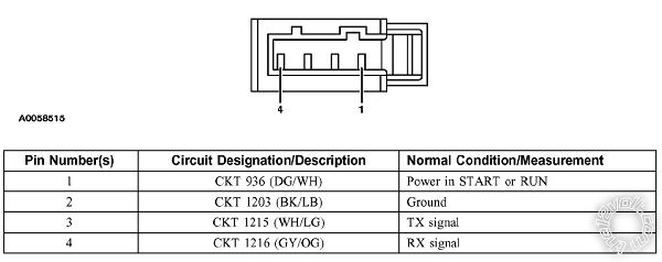

Chev is right. There should be some wires going from your bypass module to the cars anti theft system. From what you've described the bypass module is only connected to the remote start and is not communicating to the car's anti theft system. The point of the bypass is to emulate being physically inside the car and inserting the key, then sending this information to the anti theft system to start your car remotely. Your anti theft system plug should look like the picture below and is located around your steering column. Make sure there is nothing lose going from the bypass to the anti theft wires.
automate am1 remote start issue - Page 2 -- posted image.
