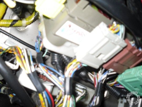

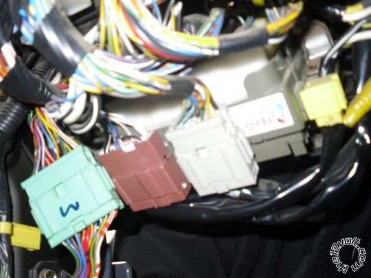

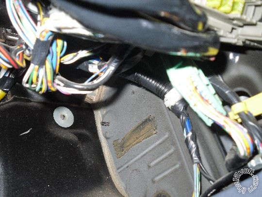

Please see attached pictures. Thanks

Sorry, doesn't help at all! I was actually looking for the plugs, top and bottom. Get out your DMM and test, it can't be difficult. I was wrong earlier, it's based on the CR-V of that year.

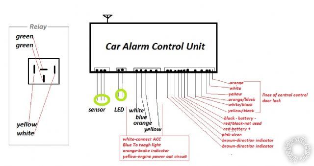

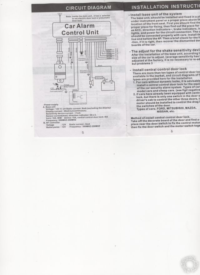

Please see the alarm circuit which I want to install. Apart from foot brake,ACC,LED,Siren and battery connections can you please guide me the connections for the other wires like....Blue to toagh light,brown direction indicator,brown direction indicator and central locking.alarm wiring, 97 honda s-mx - Page 2 -- posted image.

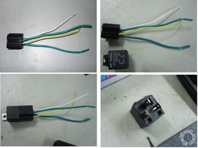

How to connect this wires of relay
kaalz
Posted: October 07, 2011 at 3:13 AM / IP Logged
Cut the starter wire. Join the greens to each end.
One wire the white? I can't read the diagram, goes to the alarm's GWA (ground whilst armed), the other yellow probably to an alarm lead marked ignition, also joined to the vehicles ignition.
With the locking you're on your own, I'm GUESSING a white control unit in the driver's door (CRV style). It could be either neg swiching or 5 wire you will have to test or post a photo of the unit.
Could we please have a list of the alarm wires, colours and functions.
Having seen your answers I strongly suggest taking this to a pro. to have it installed.
where does the white wire of the relay go...will post the post of the door control soon.thanks
kaalz
Posted: October 08, 2011 at 2:31 AM / IP Logged
As you can see from the diagram the yellow and white from the relay go to the yellow and white of the alarm. The white also goes to the BLACK / YELLOW of ignition, NOT ACC as shown in the diagram.

does the blue wire from the alarm go to doom light and the two brown wires go to the left and right indicator?
