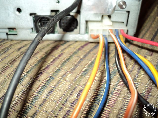

Clarion tvx5653 2000 model wiring and acc -- posted image.

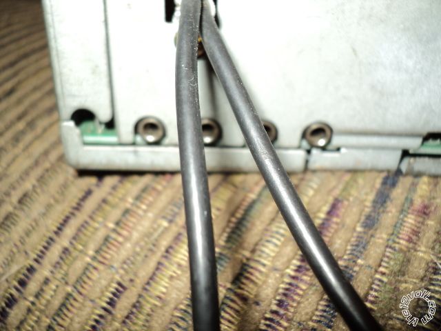

That doesn't help, thanks though. I have a 12 pin connector, Red, yellow and black, I know what those are. I also have a solid blue (remote?), ORANGE / white stripe(illum.?), blue with yellow stripe?, and solid orange, I know they're not speaker wires, this uses the antenna in/out to pass sound to your head unit. I'm wondering which may be the park/brake safety, so you can't turn it on unless your car is in park. Also wonder what the four 1.5mm jack inputs/outputs may be for. I know the two larger ports, the 13 pin round one is for cd changer, the other round one is for A/V input wire CAA-389, which I also need but can't find online. Like I said its a Feb. 2000 model, so I can't understand why I cant find an install manual, or wiring diagram anywhere?

Correction: 3.5mm jacks - seen in left picture on bottom of unit.

cj404
Joined: November 15, 2011
Posted: November 16, 2011 at 1:27 PM / IP Logged
Alright, apparently you didn't read anything I wrote or look at the pictures. I know what red, yellow, black, blue, and ORANGE / white are. No,ORANGE / white is not speaker its illumi./dimmer. Yellow is constant 12v with 15a fuse, Red is ignition. Yes, blue is antenna. I know this already. Sorry, when I wrote Blue / YELLOW, I meant blue/white, it is remote. I'm lost on the solid orange one. This is a stand alone TV unit that does not have speaker outputs on the harness, it uses the antenna in/out to play sound through 88.3 FM. Speakers on a standard harness would be f/l-white, f/r-gray, r/l-green, r/r-purple.
They're should be a parking brake wire and a reverse camera trigger wire, that's what I'm looking for.
I'm also lost with what the four 3.5mm jacks on the bottom right are for?
