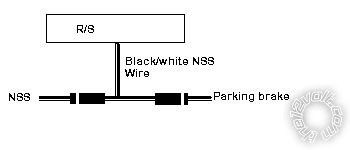

Assuming your vehicle has one...either or gearbox or engine management ECU, use this set up with 2 x 1n4004 diodes, it's belt and braces:- C63_nss.bmp

That wire has to see a ground, either through the NSS or the parking brake. If you go to a library or on-line see the engine management pin-outs, that will tell you if it's there connect to that and leave in auto mode.
Or connect to parking brake indicator wire and leave in manual mode.

so after much research, have come to the conclusion that the neutral switch and the NSS are two different switches.. the neutral switch is my clutch switch, which i thought was the nss coming from the ecu..
anywho, I will attach my nss BLACK/ white output to the ebrake accordingly(ground out when brake is on) and attach the [H2/10- (-) 200mA status output] to my clutch switch(seeing ground when pressed in) with a diode inline, to "bypass" my clutch.
