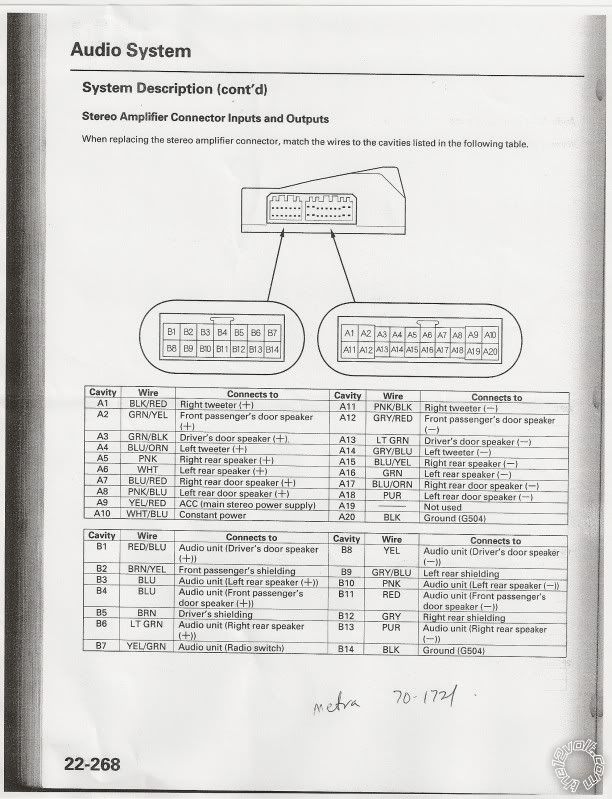

Hi folks. I'm in the process of replacing the stereo in my Acura TSX and found this picture of the wiring diagram, color codes, and/or pin locations.
For the time being, I will be leaving the stock stereo in the dashboard until I have more time to custom fabricate a dash kit.
If anyone knows who makes a kit for this car, let me know.
Thanks.04 acura tsx stereo wiring codes/plug -- posted image.

Posted: November 30, 2011 at 10:54 PM / IP Logged
Unfortunately no one makes a kit for this vehicle
This information is provided only as a reference.
All circuits should be verified with a digital multi-meter prior to making any connections.
