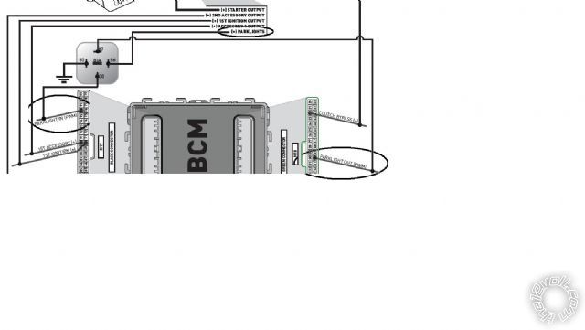

Looks like I'll be doing my 2010 Altima this evening. Went to Fortin's website for a last check for updated install manual on the EVO-All and they actually had a simplified install manual up. Gave them a call and it works with the hardware / firmware version bypass I have so I got everything prepped and we'll see what happens. I'll post up my findings. The only thing that is weird is that this new manual doesn't say anything about a parking light wire so I'm not 100% sure what I'm going to have to do there... possibly just a hardwire connection between the starter and the car.

Parking lights are in the kick. Or you can use the parking light wiring diagram and do it at bcm.

Posted: December 19, 2011 at 5:03 PM / IP Logged
2010 Nissan Altima PTS Remote Start Pictorial - Page 3 -- posted image.

I just went to the underdash fuse box for the lights. Then everything else was at the BCM. There was a 12v constant wire (about 12awg) that the EVO directions seemed to believe it was fine... and after a bunch of testing, it seemed to be fine. With everything through data, I can't imagine the amperage draw being much at all through the 12v input.
Everything seemed to work perfectly from the new EVO-ALL manual. It used the can high / low, and the RX/TX at the key insertion piece right on the knee bolster. It then used the brake 12v constant and switched input (for starting). Also checked for ability to start in all gears and it would only start in Park and Neutral... so no issues there either.
Everything went really smooth and it was possibly one of the easier cars I've done. Even the tach signal through the bypass was good.
