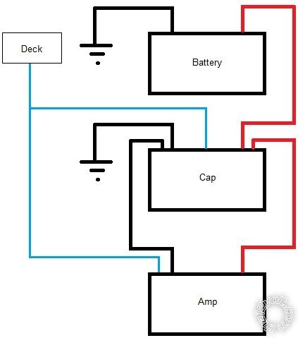

So this is how you are currently connected?
raptor 5 farad led fails to illuminate - Page 2 -- posted image.
I personally have no issues with this, and if all of its connections are tight, there SHOULD be little to no difference (electrically) with this particular diagram or having a dedicated chassis ground for the amplifier...
If it is connected this way, and the ONLY thing that is at this moment NOT functioning correctly is the display, don't worry about it. If this is the second time the display has died, then I'd say they are just crappy display circuits, but the cap itself will still be "working". Those of us that KNOW better, will still strongly recommend you remove the cap altogether, upgrade your alternator, and possibly add a small sealed gel-cell battery at the point where the cap is, and call it a day.
You *do* seem bent on keeping the cap, so... to answer your ORIGINAL query, the cap is fine. It is still doing the same thing it always did (little to nothing), it just doesn't tell you the voltage at the terminals anymore.

Yes thats the wiring. Lastly,what increase of integrity would a ground from amp to chassis do if any.losing a new cap....320 with labor is not an option,amd there is no upgrade for alternator for a 1999 nissan sentra.

Assuming it is shorter - ie, you reconnect the cap GND to the amp; or the amp GND to chassis - it can only improve. (IE - lower impedance.)
Lower impedance to the battery, yes, but higher impedance to the cap (due to 1: longer wire, and B: more physical connections) - the device that ideally MUST have the lowest impedance connection to the amplifier, to gain as much as can be gained from the perceived benefit of a cap in the first place... Right?
Leave it wired up the way it is, forget the display (it does just as much as the cap does), and go about listening to your system.
SERIOUSLY look into the alternator option. If your alternator (THE source of all the power in your car) runs short of current, all of the other devices (lights, fuel pump, windows, COMPUTER... bad news to starve your ECU of current...) in your car will feel the pinch, as well, and possibly, depending on the device, even moreso! A $600.00 alternator is cheaper than a $300.00 ECU, plus installation, plus diagnostics and the time you're without your ride...
