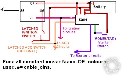

Kenny, the install sheet has it as an input/output. Now leave me whilst I watch an important soccer match from Birmingham (England*) and do a schematic for our friend.

This diagram should show everything and answer Mike M2's point about ignition kill, also separate control of ACC.
Procedure:
R/S running, turn off alarm and enter car, flick on ignition and ACC switches both should be latched, the ignition 2 amp, the ACC 10 amp power handling.
Foot down on brake pedal for takeover and away you go.
To stop the engine just turn off ignition switch. (I still think my original off/on 1/on 1 and 2 is simpler).
For normal starting, flick the ACC and IGN switches press the starter button.
Don't use any micros, they won't latch or hold the current required.
