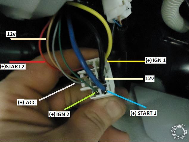

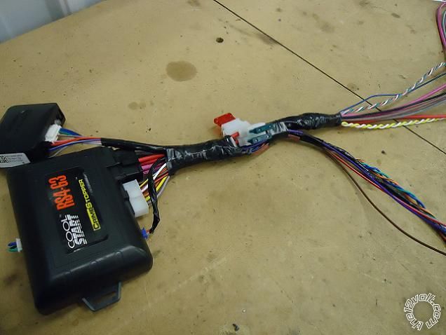

I used a Crimestopper RS4-G3 with a ADS-TB Bypass module
Pre-wire:
2011 Toyota Avalon Std 80 Bit Key Remote Start Pictorial -- posted image.

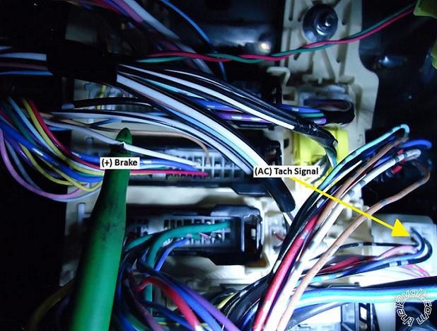

At Driver's Fusebox

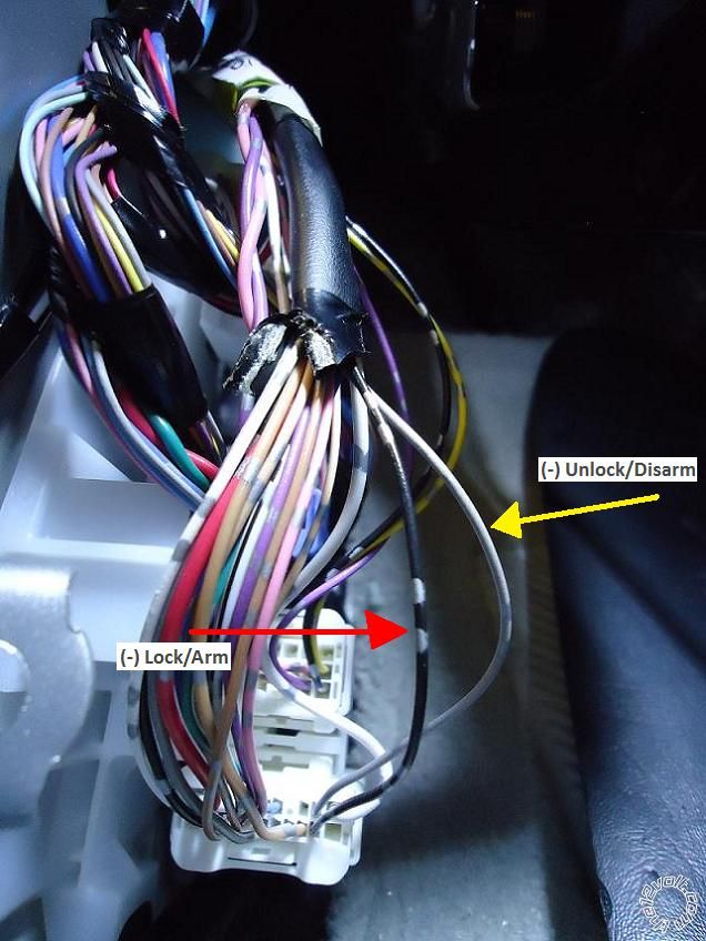

Lock/Arm and Unlock/Disarm in bottom plug of driver's kick panel. For unlock/disarm, a single pulse will unlock the drivers door and disarm the factory alarm (if equipped) and a double pulse will unlock all the doors.

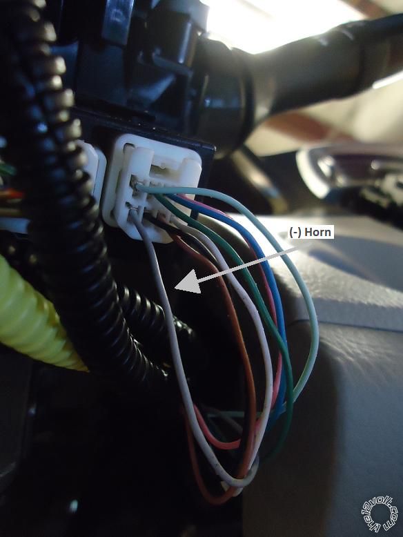

Located at the plug connected at the horn switch

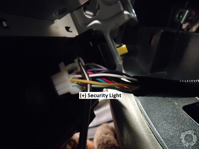

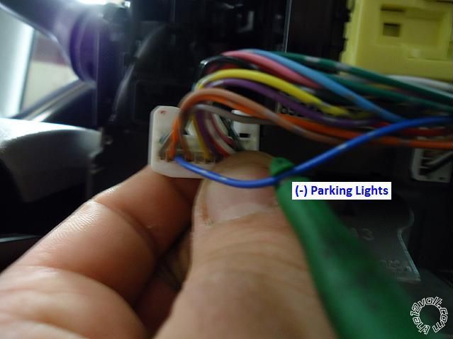

Located at the Parking Light switch (In close proximity of the horn wire).
Easily accessible at the Ignition Harness.

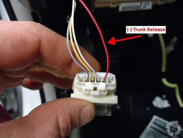

Located at the trunk switch which is located to the left side of the knee bolster.

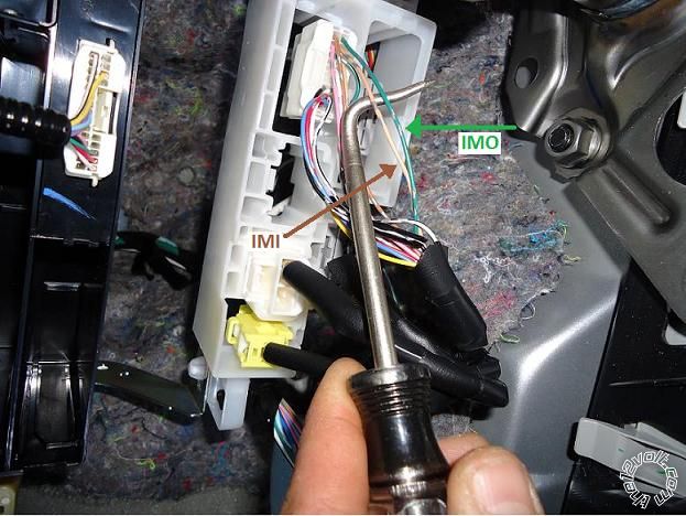

Bypass wires located behind the glove box high in the passenger kick panel. Required for the ADS-TB Immobilizer bypass. I had to perform this procedure with the bypass, even to it programmed perfectly, to get the vehicle to start. ADS Tech Tip

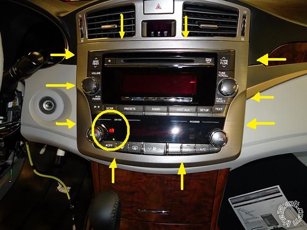

How to access the security wire. (10) Clips will remove the trim around the radio. I find it easiest and the most dash friendly to using my non-marring pry tool to remove the trim. (Not required with the Fortin EVO ALL)

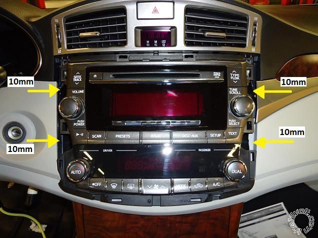

Magnetic 10mm socket a must for removing/installing this radio (Not required with the Fortin EVO ALL).

Great pictorial. With vehicles where the instructions want you to attach the security LED, I have not connected this wire and the bypass works perfectly. Just thought I'd add this to your information.
I'm aware of that. It's just a cosmetic thing so the security light doesn't come on while the vehicle is remote started. I think it's a waste of time but my boss is anal.
