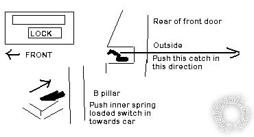

On the "B" (central between front and rear doors) is a catch or "door shut" built into it is the domelight trigger switch so while testing you must also wedge that open!
Use a plastic "Bojo" trim tool or a door stop or a large screwdriver or a helper, again if left it disables the locking so you can't test. Some Hondas work the same way.

I just did some terrible diagrams to point you in the right direction:-

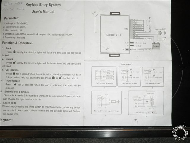

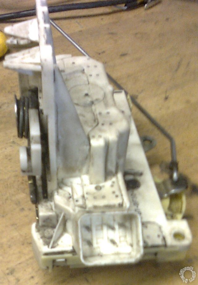

Hi this is my daughter car. I´m still waiting for her to come home so I can check this. She is with her boyfriend I will go to day and check the wires, Straight when see comes home Bud when I put the alarm in the car I checkt the lock by domm lock the door and disable the light. And the driver locks are working fine. locking and opening with keys and the inner lock switch works fine. The aftermarket remote is already in the car and I connect the BLACK/ green to remote close wire and BLACK/ orange to remote open wire but like I said that dosent work I also try to connect it staight to body with test lamp be tween. that dosent work neither. Why cant I open and lock with remote like when I use the key. I mean like I turn the the key to open or lock something happen in lock. Like i can make it open with my remote bud not lock. I borrow lock from partsale To try to see how it works. 3 plugs are to open close and 2 are motor?    I know there are two plucks to the GM 1 blue and 1 green. This car are made in germany.

this are the lock from the partsale which are the same in the car

I messing this up a again (BLACK/ green) to open and (BLACK/ orange) to close stupid me !

That diagram is unreadable!
How about listing the wire colours and their functions.

try this one there are difrend ways to connect so you have to see the diagram I used the negative http://s1077.photobucket.com/albums/w467/rikkimagg/?action=view¤t=8-4-2012012.jpg click on the image to make bigger!
I dont have scanner at home bud I can go to my work place to scann it if this are not readable !
Posted: April 08, 2012 at 10:25 AM / IP Logged
Just copy the wiring list and colours from that diagram and post them, I'll do the rest.
