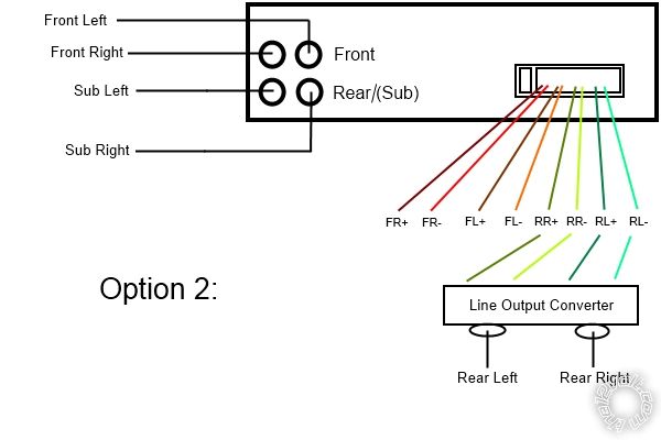

I recently bought a JVC KD-X50BT with 4 pre-amp outputs. In order to use my stock sub with the aftermarket amp, I need 6 pre-amp outputs. I was thinking of using the provided +/- speaker wires coming out of the back of the Head Unit hooked to a 2/4-channel Line Output Converter
(LOC).
This would convert the wires to RCA that I can hook into the aftermarket amp. Is these a feasible feat? Any loss of sound quality or other side effects?

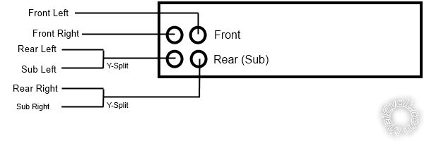

You can do that, but yes you will end up with a lower quality signal than just line level out from the HU.  Why not just use Y-cables?

Posted: April 28, 2012 at 3:14 PM / IP Logged
This is what you are proposing, DYohn? It could/would have to work. :)

For further clarification, this is what I proposed when I first started this thread:
hu, using rca output vs wires -- posted image.
So by using a LOC in this manner, my signal quality will be lost?

Platinum - Posts: 10,741
Joined: April 22, 2003
Posted: April 28, 2012 at 3:40 PM / IP Logged
Using an LOC will almost always result in a lower quality signal than using the line outs from the HU, mainly because you are adding in the distortion of the HU on-board amplifier.  Option One is the better solution.
