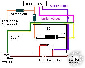

8)Wrong Use the GWA wire see above and this diagram, I've corrected for the Mits and the Code colours:- BF3_starter_cut.bmp
You will need 3 1N4004 diodes, one may already be on that relay.
As you can see, dead easy.

The Purple Starter Output can be connected directly to the vehicles Starter wire at the ignition switch harness.  If you want Starter-Kill, then
follow the instructions and install the supplied relay.

8. Thanks a lot for this diagram. I'm going to do this . I see diode or resistor...mmm dummy, going post picture for you . It's connected in parallel 87-30

5) That wire has to see a ground before the remote will activate.
On an auto I connect it to the reverse light wire, locations and finding the colour as above. In park or neutral, that wire will be at ground. If a thief gets into your car during the remote start cycle and attempts to move the shift lever out of park, reverse will be the first to engage shutting off the r/start.
Parking brake switch at it's base, there will be a switch with a single wire coming off it. That's the alternative though on autos I always go for reverse. This wire always (on any car) reads NEG (-) when the parking brake is engaged.The person who said ignore that wire in Q.5 should be ignored! That wire MUST see a ground for the R/Start to work.
8) Diodes (all 1N4004) no resistors, the one across 85 and 86
NOT 87 and 30, that would blow out the relay's power fuse to 86! It goes across the relay coil, 85 and 86, band to 86 when (as in general convention) 86 is the POS (+) side of the coil.
The next question, at a guess BLACK/ red is the reverse light wire I mentioned before.

F...k spent whole day on assembling and after assembled all wires ( nothing about remote control ) the horn and siren start chirp like crazy, and only key in ignition for 10 second can stop it, after that it's show that it's arm, everything blinking like should , but nothing going how it should be.
1. The doors not locking, and when I lock them manually they don't unlock.
2. In disarm position I have blinking icon on my fob ( like door was opened ) even it's closed.
3. When opening trunk with key, the alarm not start. Should check tomorrow everything.
Never thought that's it take so much time. Plus to make all this wiring it's really a pain in the ass, because they are located it such place. Not very convenient...
I have couple theories why the door's is not locking.
1.First, the wire orange and light green black is not that wires that need for Lock, Unlock and Arm,Disarm. So R/S not get information from key cylinder.
2. Or I screwed up with door pin, and it's not get information that's why it's think that door is ajar.
3. If the lock switch is working, like in loop may be it's give the signal to R/S that passenger lock switch is hacked. Because, right now I don't have passenger window switch with lock button.
4. I have not just simple negative lock.
   But:
    a) Reverse polarity locks - Rest in ground and register positive voltage when the lock and Unlock switches are activated.
    b) Negative Multiplexed locks - variable ground when switch activated
If this is going be true I would need additional parts to install for appropriate work of car alarm.
Huh..will do tomorrow double checking for each variant. There some problem that I going figure out. For sure.
If somebody have some suggestions would be appreciated to hear them.
