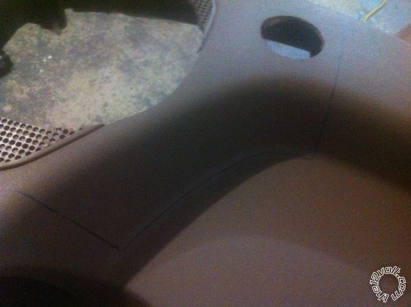

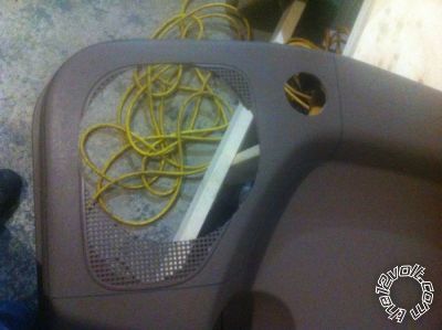

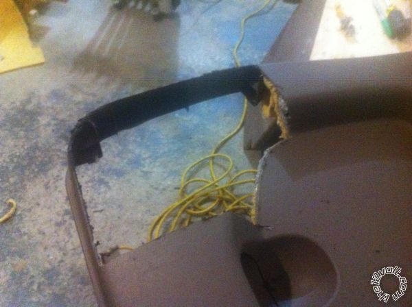

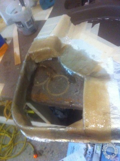

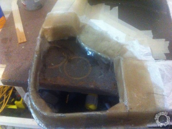

Started on the doors, going to install JL Audio C5-650.
Cut the door panel and laid down the first layer of FG.

Cause of the cold in Dirty Jersey the resin is not hardening well. Anyone know where i can get a good heat lamp or something for it??????
I don't want to spend a lot,, $20-$30 if i can get away with it????

mix the FG right... no amount of heat lamp will help a fiberglass project that isnt mixed right. not intending to be mean, im just speaking from experience. ive had a few fiberglass pieces scrapped because i didnt mix the resin the right way for the temperature.

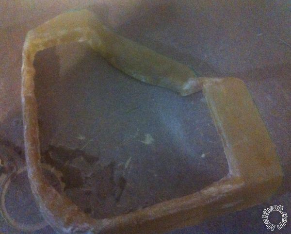

I used a 1000 degree heat gun $30 from ACE and more MEKP when its cold. I learned the hard way....in the dumpster below is the driverside of my trunk.....
z03mz03m wrote:
Well I have another reason why I hate winter....
winter + fiberglass = MORE MEKP2007 Nissan Pathfinder, Fiberglass Projects - Page 3 -- posted image. 2007 Nissan Pathfinder, Fiberglass Projects - Page 3 -- posted image. 2007 Nissan Pathfinder, Fiberglass Projects - Page 3 -- posted image.
Oh and don't use doodiey tape. And always use two layers...its not a waste.
I didn't care because I was going to put black carpeting over the sides of my trunk anyway. But if that had hardened it probably would not have come off.

Put on a 2nd & 3rd layer of FG with 3M resin (poly type), first layer took forever to harden, 3 days. This time I used a room heater and 3M resin ( worked 10X better then Bondo CR@p resin..... ill never use that stuff again. Lesson Learned !!!!!

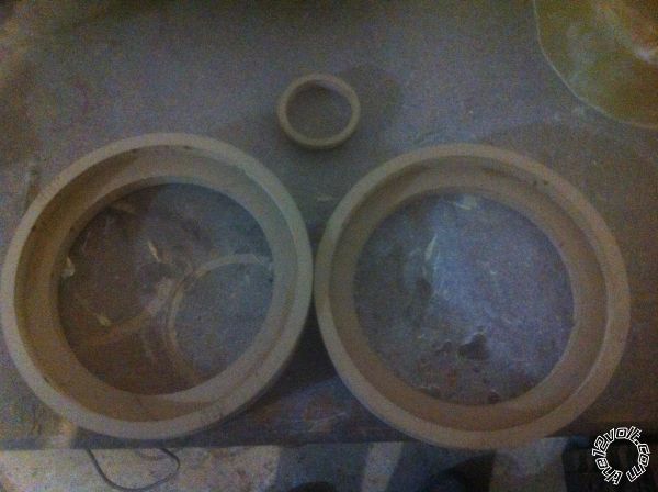

Trimed up the FG Door mold.

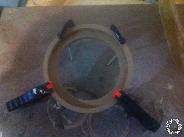

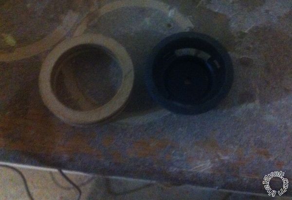

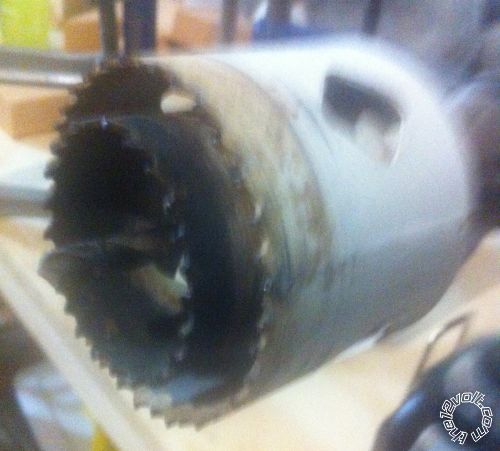

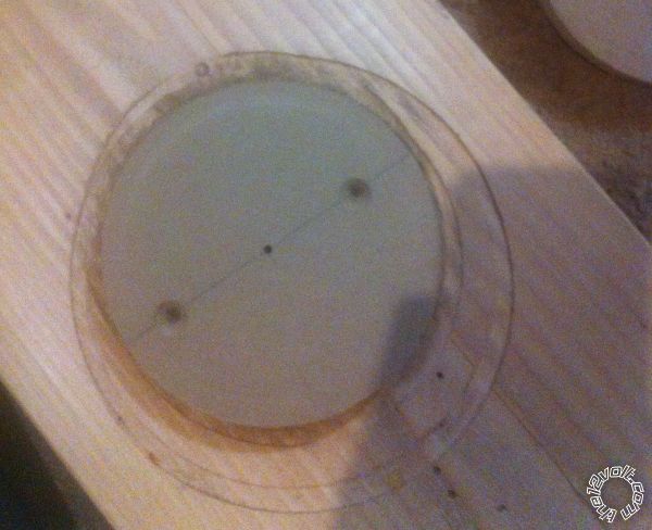

Cut out the 6.5 mdf rings and the tweets.
Make life easy i used 2 hole saws together came out perfect.
Counter sunk the screws to hold down the mdf for the Tweeter rings
need to make last tweeter ring :) , the rest all sanded and done
