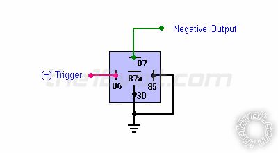

John07 You are absolutely correct, for the RS-00 for crimestopper, you do not need to hook up the lock/unlock wires to the BCM. You would only need to do this if you were using an aftermarket remote starter that came with remotes and had keyless entry buttons on it. Since the RS-00 doesn't come with aftermarket remotes and is activated by the factory Key Fob you don't need to wire in the blue/green lock wires from the crimestopper to the BCM. You do however need to connect the green (-)activation wire coming off the red 3 pin plug to the drivers door lock motor wire. This wire is located at the BCM and is Purple in the black plug Pin. It will test as a Positive on your meter when you hit lock either on the keyfob or the door panel. You will need to add a relay to change the Positive pulse you get when you hit lock to a negative pulse. fortin evo and remote start - Page 2 -- posted image.

I am almost done with this project. Everything seems to be working  with the data cable hookup. I hooked up 2 relays. One for the Anti grind and one to reverse the door lock trigger polarity. I added 2 diodes for the GWR like it said in the manual if hooking it to 2 different things.  I noticed that a red led stays lit up on the Evo-Can after the car has shut off. This is either with the key or remote start. After it remote starts, I get a red and a yellow while running. I just think it's weird that a light would stay on all the time. Wondering if this is normal. One other thing I noticed is that after a remote start the factory alarm led stays on solid while driving.
