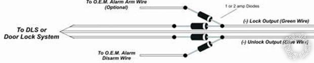

I want to incoporate the factory alarm with the keyless entry I installed.If I tie into the factory alarm arm/disarm wire can I use the lock/unlock output wires to turn on/off the facory alarm?Should I diode isolate these wires so they dont feed back into each other?Any sugestions/ideas would be appreciated.
Yes you can control the Factory alarm via the arm/disarm wires.
Yes diodes are required as per this diagram.
[/FILE]2006 malibu, keyless entry wiring - Page 2 -- posted image.

Because I used relays to the door locks do I still have to diode isolate from the relay output to the door locks or can I just isolate the output from the keyless brain to the factory arm/disarm wire.It is a single wire to arm/disarm the factory alarm.
Manny
lurch228
Silver - Posts: 1,338
Joined: August 08, 2012
Posted: November 28, 2012 at 10:33 PM / IP Logged
Since you used relays and as long as you are still connected to the single lock/unlock (Mux) with the relays then yes as the arm/disarm is no longer directly connected to the locks as it would be without relays.
