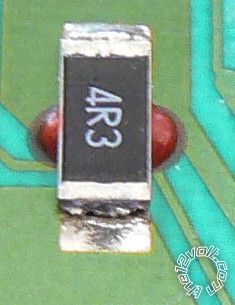

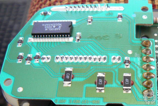

I wondered if I could disassemble the defective mirror and locate the source of the problem, causing no Heading or Temperature Display.
I used a very small, thin blade screwdriver and carefully pried it in the gap of the Front Bezel, carefully pushing it towards the rear of the mirror, and working my way along the mirror. As I approached the lcok tabs the Front Bezel would pop, and move out slightly. I continued working around the mirrors Bezel. Once I had the Front Bezel removed, I removed the Circuit Board along with the Mirror assembly. I looked at the Temperature Circuit board and it was apparent that the Surface Mount Resistor had one side that was not soldered to the Circuit Board. I used 63/37 .050" Solder to to re-solder all three of the Large Surface Mount Resistors.
After half reassembling my Mirror, I tested it and it once again worked.

Attached are the Circuit Board Images, before repair.
Gentex 261 Mirror Repair -- posted image.
