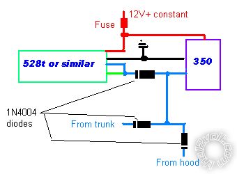

im trying to connect the proximyti sensor to the alarm

If it has the following wires;
Blue
Green
Red
Black
Join red and black to the 350 ground (black) and red 12V+ after the fuse.
Join green and blue then Y connect to the 350 Blue.
Use diodes, bands away from the 350. As per the install diagram or look at this:-
