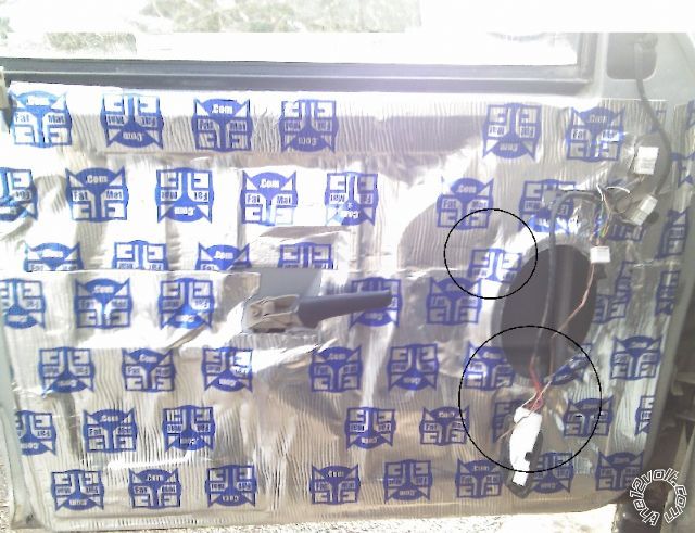

ok so second thought... what if i keep the 6.5's i have and add a 10 or an 8 in the door like this: maybe use fiberglass or 1/4" MDF to build a new sheet on the door (cover the old holes and make new ones). or should i weld in new aluminum? say 1/8 or 1/4"?
the circles being where i would put the speakers. id think of building a gradient on the MDF or the fiber to angle the speakers more towards the occupants heads. does that sound like a plan?

i accidentally selected the original image, here is the idea for the new door.

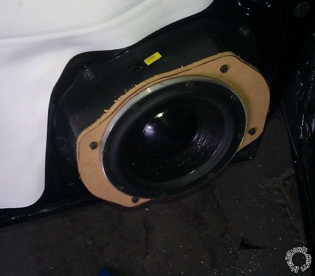

so did you just screw the 6.5 into that 6x9 hole? or did you make a cover plate to fill the gaps? if not then that is probably your problem. just like a sub woofer, a mid can benefit greatly from being in a box that separates the front audio wave from the rear audio wave. using a cover plate basically turns your door into a box, without a cover plate you could be a victim of wave cancellation and thats why your mid isnt as powerful as you think it should.
it should look something like this when its done.
mixing brands of mid/highs -- posted image.
