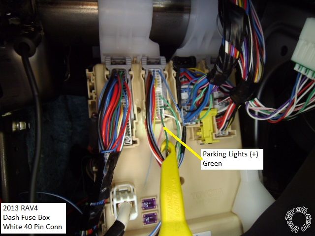

You can also find (+) parking lights (green) at the fusebox next to the brake wire.
I drink current, eat ohms, and bleed voltage
Platinum - Posts: 7,828
Posted: June 08, 2013 at 1:42 PM / IP Logged
Just an update with some more info.

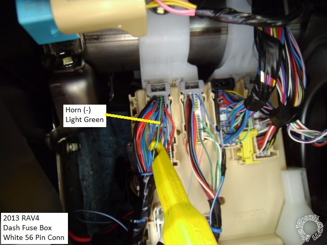

As PTS760 pointed out, if you prefer using a (+) Parking Light wire or would rather make your connections at the
fuse box instead of the steering column, here is a photo of the (+) Parking Light wire.
2013 Rav4 Remote Start with Keyless Entry Pictorial -- posted image.
Here is a picture of the (-) Horn wire at the fuse box :

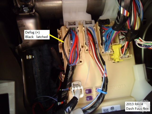

And for those that wish the added convenience ( or profit ) of Defroster control during Remote Start, here is a
photo of the Rear Defroster wire, also at the fuse box.
The Defrost is a high current, latched (+).

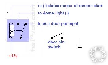

A 2013 Rav4 owner here (XLE, no factory alarm or pushbutton start).
I have a 1 button remotes start (DEI 4203v responder one).
Toyota has this feature where if the ignition is on or the key is in the ignition or the ignition on, the keyless entry system is disabled (fob wont work). (so you are not able to lock the doors in pit stop mode).
I added a relay triggered by the door pin switch when the remote start is activated. The NC contact restores original function. I ran a wire to the dome light so it will still work when the remote start is activated.
Now I can at lock the door at the door panel when in pit-stop mode.
