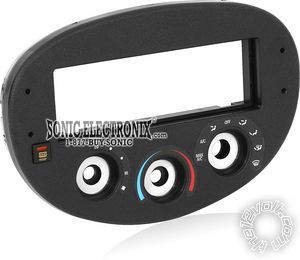

does your dash look like this?
96 escort lx -- posted image.

The dash isn't that rounded one, I think that started with the 1997 model.
