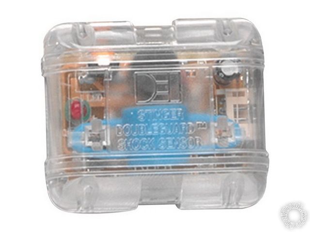

Python Install -- The Double Guard Shock Sensor won't let me adjust it through the python 2-way key fob. The Python 2-way shows a signal being sent to the Python but there is No Signal in return, I get an error "X" failed signal. I tried kicking the tires, repeatedly. I have kick very hard to get the alarm to trigger. The alarm does trigger when the door is opened.
Does anyone have any ideas why the Shock sensor isn't letting me program it? Could it be one of the menu settings?

Did kreg357 resolve the remote start issue? Also, make sure your little switch is plugged in and in the ON position.
If you have the external shock sensor, like the one below,
dball2, viper 2010 nissan maxima - Page 2 -- posted image.
Look on the side of it. You'll see a little hole to access a potentiometer. This is where you make the adjustment on these sensors. Clockwise for more sensitive. Make sure you don't turn it past its stopping point!
What model is the brain? It'll say "Viper" then the model. If it's the 5X04, the sensor is built in and are a pain. They have to be set via the remote or bitwriter. When using the remote, can you get to the settings menu? If I remember correctly, while you're holding function, it'll beep before you get the settings menu. Keep holding and it should get you in.

Another tip in my experience:
When you mount the shock sensor, make sure it is kind of loose. If it's tight, it doesn't work as well. I like to dangle the external sensors off the steering column, zip tying the wires to it just before the connector. If it dangles too much (i.e. 3 inches or more) it doesn't work.
