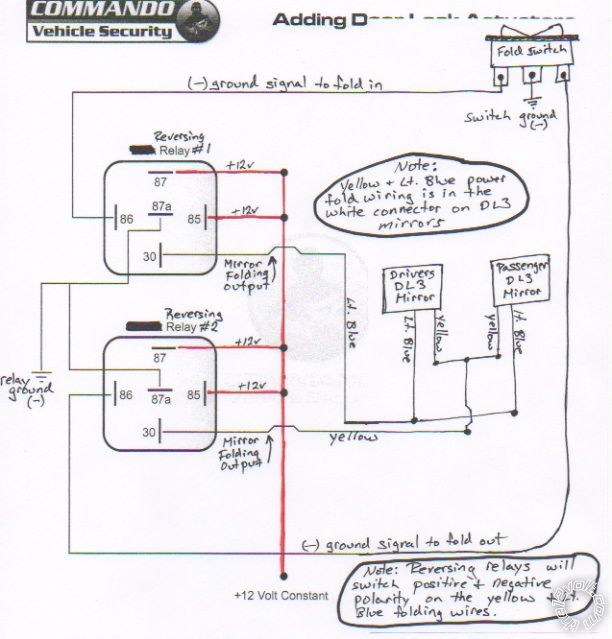

I have installed some factory DL3 power folding mirrors but no switch to operate them. I prefer to to modify my dash with ant type of switch as shown in the diagram I'm posting because I want them to either fold in/out off the Lock/Unlock function of my remote or in/out from the On/Off from the ignition.

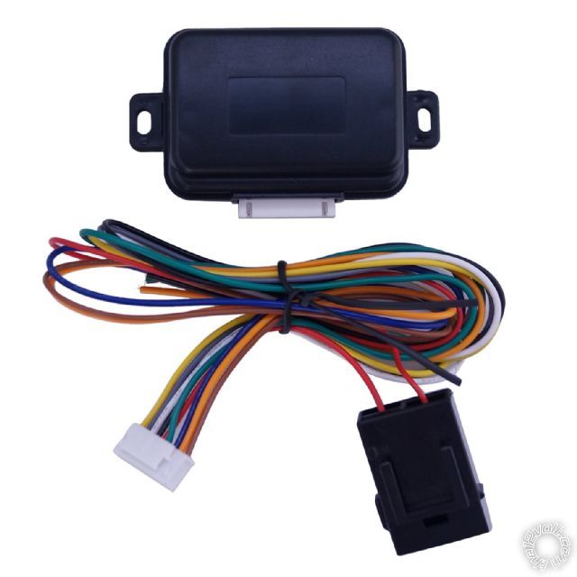

Will this relay work?
http://www.amazon.com/Intelligent-Mirror-Folding-Closer-System/dp/B008ZYPL9I/ref=pd_rhf_se_p_dnr_2

Diagram is fine but here's a question.
Why not do it automatically as the notes suggest?
That's how I'd do it.
Test before boxing up.

The hand drawn schematic is what I do not want to do.

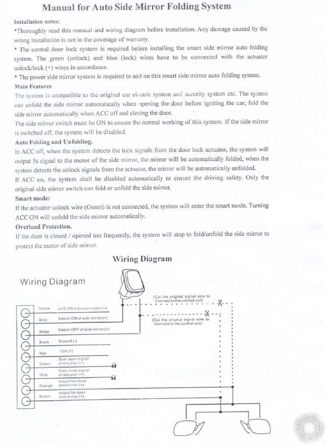

Can this be used to make it work off the ignition on/off? or lock/unlock feature of the remote FOB?

Yes the lock and unlock wires instead of fold and unfold at your relay diagram, assuming those mirrors have built in timers.
If not you need to substitute a DEI 528t timer relay for each relay.
If you pm me with your email address, I'll send you a couple of diagrams if the mirror fold doesn't have a timer, i.e. still draws power when it's completed the operation.
Except Without a hands-on I can't be positive, my impression would be to run with what's in the kit.

The photo is of the Amazon link I posted. Supposedly one for each mirror and they are universal.
I'm wire schematic illiterate. No knowledge of what to do. Population of 120,000 people and no radio, stereo or electronics store knows what to do.

The remote start will have lock unlock outputs.
Again assuming a two wire lock and unlock output from your remote start those wires should be green lock and blue unlock, both NEG (-) pulse. TEST.
If that's the case connect to the green and blue from the control unit. That will make it fully auto.
You can dispense with the control switch, just join the switch wires.
My diagrams were similar to what you've seen probably in the archives on this site, except I used 528t instead of PAC-7, they're both combined timer relays.

Control Unit? i.e. the universal relay I speak of?
I'm sorry but I am not electronically inclined.
Will I need to add timers?
1 universal relay per door?

Again without hands-on I'm guessing that the black control unit has built in timers, just try what I suggested in my last post.
