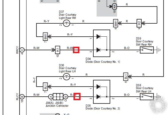

Thanks guys for the quick responses. After digging into the situation a little more, I have determined that it certainly is being caused by the RR and LR Door Switches. After peeling the onion back further, I realized that they also would not cause the alarm to activate if opened with the headlights off. When I originally connected to the wires during installation, I tested them with the connectors unplugged, so I didn't notice I was not getting a good signal from them when closed. If I measure from +12V to the R/W Wire on either, I get about 10V with the door closed and 12V with the door open. The RF and LF Doors switch completely from 0V to 12V. If I disconnect the RR and LR doors from the input, the alarm no longer cares if the headlights are on and functions as expected either way.
I imagine the door panel lights could be the reason (only present at the rear doors) or some backfeed from the BCU also is possible but strange on only the rear doors. Here is the wiring schematic directly from the FSM: -- The Red Boxes indicate where I have tied into the circuit.

And I do hear what you are saying and realize that I can tie into the keyring or some other illumination source instead of the door switches. The burglar alarm installer in me likes the door switches better, but it it isn't going to work, I will certainly consider another route.
