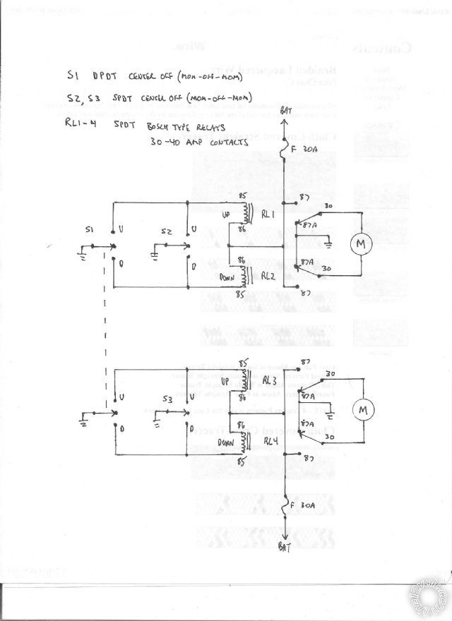

rv landing leg control - Page 2 -- posted image.

Cool! I have a couple of questions:
1) Is the dotted line actually showing the one 3rd switch I've been talking about? (i.e. Another center off switch wired into both relays?)
2) What kind of relay is shown and any suggestions on where to get them?
Thanks again.
- Jim

I spoke too soon. I didn't see the 2nd page with the updated diagram until I sent it. Sorry for the thrash. I still may have a question once I have a chance to review it. Thanks.
