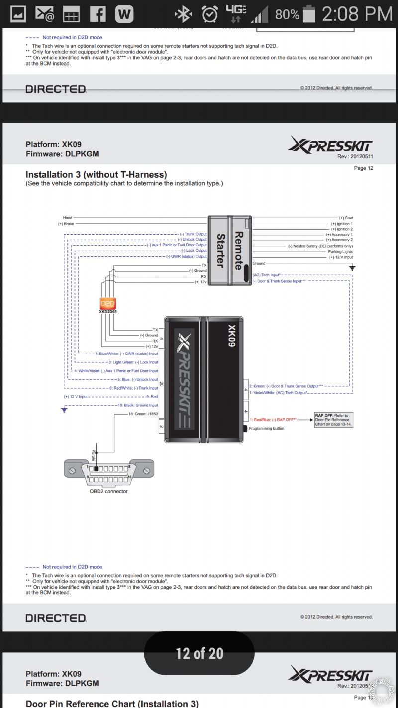

Posted: March 02, 2015 at 9:20 PM / IP Logged Link to Post Post Reply Quote chevelle212
I just uploaded a diagram of the xpresskit xk09. Tell me if I'm reading it correctely. I think it is saying that if you have the d2d plug going from the remote start module to the xpresskit module that the hashed blue line connections on the diagram are not necessary to hook up?
Platinum - Posts: 7,828
Posted: March 03, 2015 at 4:33 AM / IP Logged Link to Post Post Reply Quote kreg357
Yes.  On the XK09 w/DLPKGM, connect the D2D harness, the J1850 Data wire to the ODB2 connector and possibly the RAP shutdown wire..

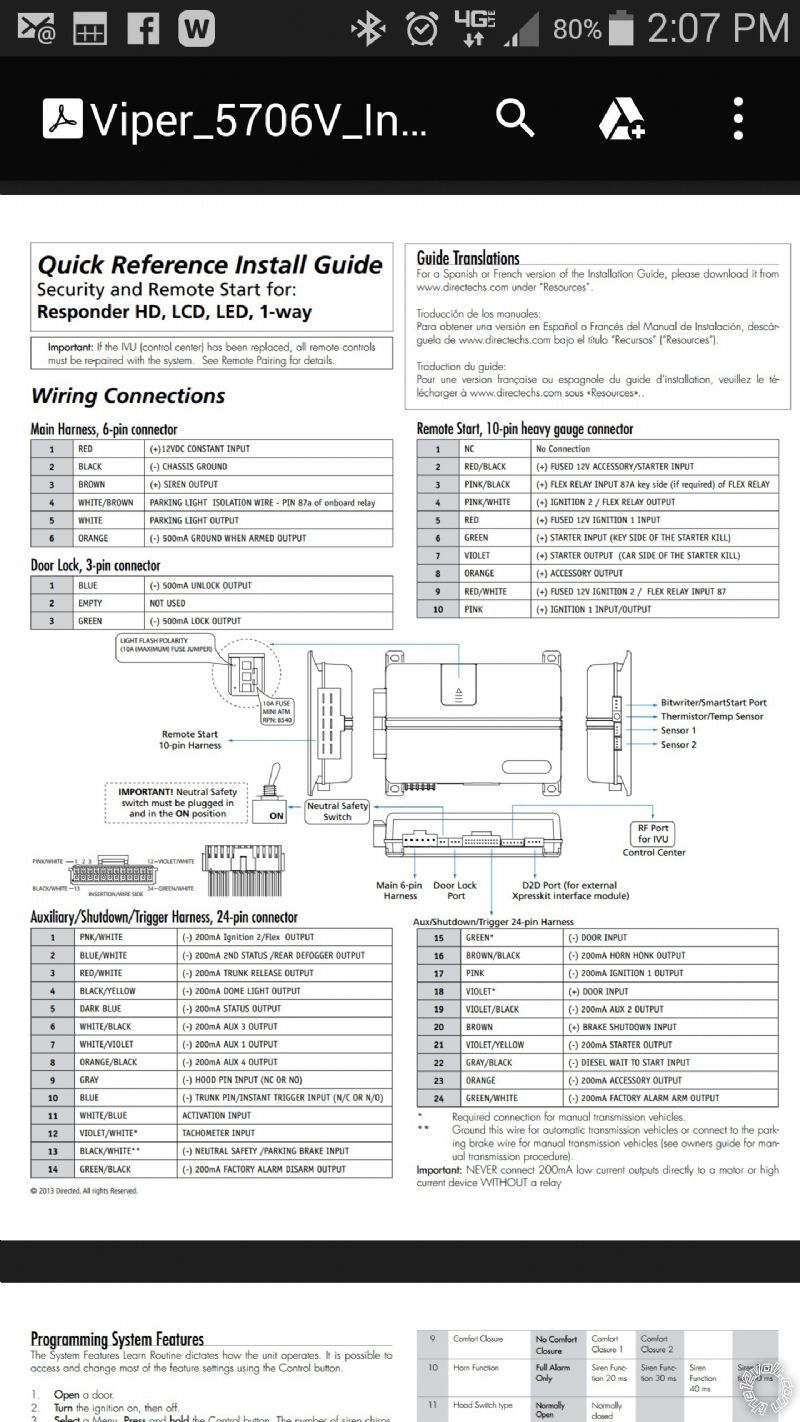

I have some technical questions about the remote start system. There are a few connections that I am clueless about, even looking at the pictorial. Not sure where these connections go or if they are needed. I tried uploading pics but can't figure out how

Posted: March 04, 2015 at 5:44 PM / IP Logged Link to Post Post Reply Quote chevelle212
Viper 5706v install 2005 Silverado ex cab - Page 2 -- posted image.

Posted: March 04, 2015 at 5:45 PM / IP Logged Link to Post Post Reply Quote chevelle212

Posted: March 04, 2015 at 5:46 PM / IP Logged Link to Post Post Reply Quote chevelle212
Ok so my question is..... what needs to be hooked up to my truck from the remote start and the xk09 module??
chevelle212
Member - Posts: 19
Joined: March 01, 2015
Posted: March 04, 2015 at 6:02 PM / IP Logged Link to Post Post Reply Quote chevelle212
or more specifically the connections that have a 200 mA output or input. Do they all need to be hooked up? And if so do they need their own relays?
