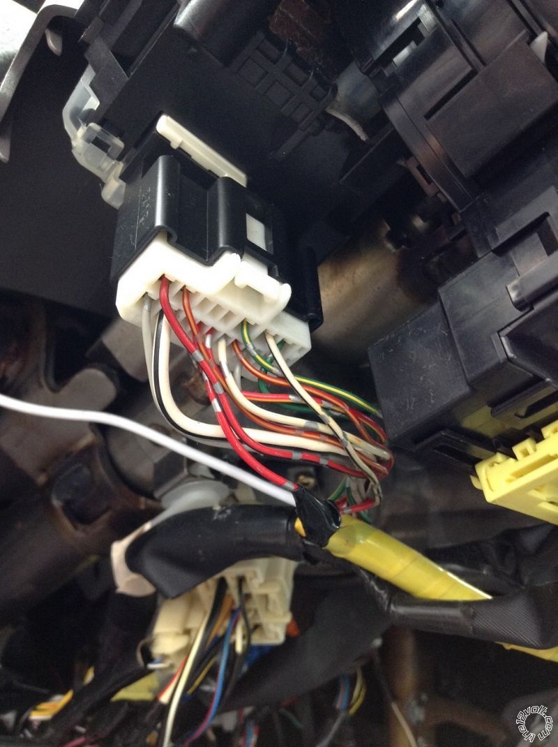

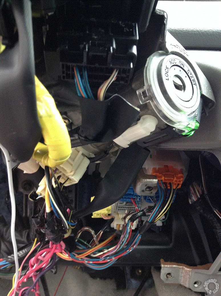

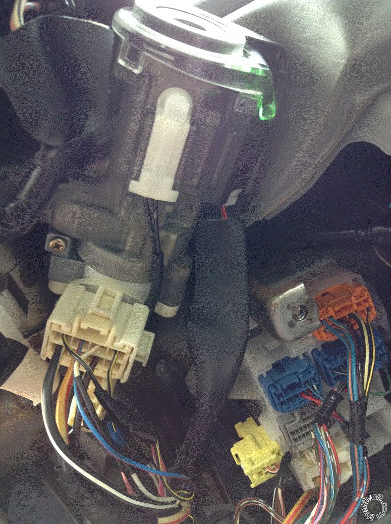

Posted: March 22, 2015 at 9:42 AM / IP Logged Link to Post Post Reply Quote w.w.rabon
5704 Python dball2, 2003 Camry - Page 2 -- posted image.
I can't find it anywhere I have a feeling It's either a different color or different area.

Posted: March 22, 2015 at 9:57 AM / IP Logged Link to Post Post Reply Quote tedmond
i see it right there. Looking at the first picture @ the ignition barrel, its towards the right side (next to the white plug with 2 wires. Look at the black sleeve, as The ring snaps into place, so carefully unclip it and the ring is fully accessible.
Take the top cover of the steering shroud off, and look from the top down. You should see 1 philips screw, and a white blocking plate. The plate covers the immobilizer wires. Its easier to just unclip the ring.
Ted

Posted: March 22, 2015 at 7:17 PM / IP Logged Link to Post Post Reply Quote w.w.rabon
no that's not it either I just double checked two wires red and blu / yellow

Posted: March 22, 2015 at 7:40 PM / IP Logged Link to Post Post Reply Quote freqsounds
Will the car remote start without the key in the lock cylinder? If so, you won't need these wires because your car might not have an immobilizer. If you take that clear plastic ring off the cylinder, you should see a coil. If you don't see a coil, there's no immobilizer and you can't use these tx/rx wires. If there is a coil, look for a pair of wires in a single connector. It could be those BLACK/ grey wires on the white connector. You'd have to test them.

Posted: March 22, 2015 at 7:50 PM / IP Logged Link to Post Post Reply Quote freqsounds
Tedmond might be right. How many pin holes are on this particular connector? Scratch colors for now. Does the connector have at least 5 pin holes? If I remember, the TX was pin 4 and rx was pin 5. Could have that backwards, but point being, sometimes the colors don't match up in DEI pinouts.
