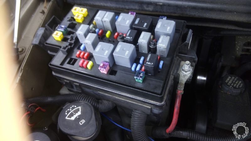

now I have a problem with my car. I got home and turned the car off and it said my door was open on the alarm so I went back out to the car and cranked it and it worked fine. I turned it off and went to turn it back on and all power went off and nothing. it was dead. I pulled the power cable off the little box with fuses under the hood and put it back on and the ignition showed lights then I tried to crank it and all lights died again and nothing. I pulled the cover off the fuse box and moved the box and wires around a little and it got lights again and power then I tried to crank and dead again. I disconnected my connections for the alarm and still same thing. Any ideas on what could be causing this?
**UPDATE**
I think I found the issue. Not sure what I may need to do to fix it or even how to replace this. here is a pic of it:
icbm7071 alarm in 2005 Buick Rendezvous - Page 4 -- posted image.
Here is what it is doing on this video and why I believe this is the problem. It seems that the battery terminal connection isnt making good contact anymore. I have the connection tight but makes no difference. If I keep pressure on the cable on the box I can get it started too. Wish I would have found this before I disconnected all the Ignition wires and stuff from the alarm. :(

Looks like the issue has to do with a bad connection from fuse box to battery.   Having a hard time finding it so I am going to take it to the shop.   I did away with my accessory 2 wire I was going to use with a relay because it is not needed.   My remote start cranks the car then acts like it isn't getting a tach signal and turns off.   I am wondering if the evo-all needs to be programmed to send a tach signal to the alarm? I have it all wired up per my prep.   The lock and unlock and lights are all working through the evo-all with no problems. Not sure if it is sending the brake signal either.   Do I need to hook the evo-all up to the PC and adjust the settings?

Got my car back today. They said there was some loose wires under the hood that the fixed and all is good now. Also was informed my fuel line was leaking and they fixed that so I am lucky I didn't blow up. Unfortunately someone stole my license plate from the car in there lot so I gotta get a new one. But back to my remote start issues. I am wondering if the EVO-ALL needs something else programmed to make it send a tach signal to the alarm or something. Anyone have knowledge on EVO-ALL that can tell me if I missed something? I will hook up to the evo-all tomorrow to check it out. I may just have to run a tach wire and brake wire myself and bypass that part of the evo all if I cant get it to work.

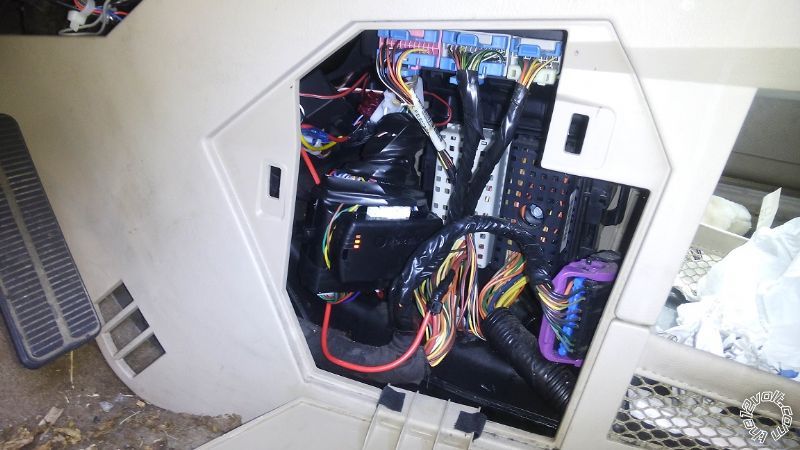

Got my remote start on the alarm working now. had to run the same wire for tach to a 12v constant and that worked because it said I could use a tach signal or 12v constant instead. I installed the brain in the center area of the car console. Thank you to all that helped. Now I guess I will sell the Fortin Flash Link Programmer.
Platinum - Posts: 7,828
Posted: October 11, 2015 at 6:26 PM / IP Logged Link to Post Post Reply Quote kreg357
Install looks good and clean!
That's the general consensus, the off-shore R/S units always have issues with the Tach.  Think it was Howie II that coined the phrase...
"If it uses the oil pressure switch to know the engine is running, bin it!"  icbm7071 alarm in 2005 Buick Rendezvous - Page 4 -- posted image.
Should be able to sell the Fortin FlashLink cable on EBay and get most of the money back.
