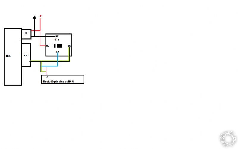

Posted: June 22, 2015 at 9:05 AM / IP Logged Link to Post Post Reply Quote howie ll
Double pulse from factory disarm, here's how:-
The diode on the relay is a 1N4004.

Posted: June 22, 2015 at 11:07 AM / IP Logged Link to Post Post Reply Quote jsigna
After looking at the picture I see the Relay 30 prong also is wired back to the GREEN/ black. Now is that to replicate the "2 pules"?
Can I just set the Viper to use double pulse factory disarm and then wire the relay like that minus the 30 prong wired back to the GREEN/ black and only to the pink BCM?
Sorry and thank you so much!
Posted: June 22, 2015 at 11:10 AM / IP Logged Link to Post Post Reply Quote howie ll
No AFAIK the Viper can't provide a double pulse on factory arm disarm, the relay is simply in series.
The way I showed the wiring the GREEN/ black factory disarm gives the pink factory disarm its first pulse then the relay gives it the second pulse.

Posted: June 22, 2015 at 11:26 AM / IP Logged Link to Post Post Reply Quote jsigna
Thank you so it is not a amperage thing it is a way to make a double pulse.. Nice.
Check this out:
Could I do this instead?
