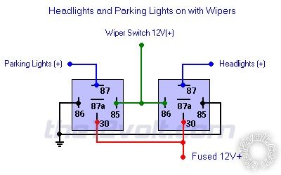

The diagram at top of page tells you where to wire and it's sidelights not headlights.
If your vehicle uses amber direction indicators go to green /white from hazard flasher (test).

you mean your parking lights rather than headlights, headlights why not ?. someone told me it could be that, but I will follow your advice. what are the other errors friend ?. you me you helped. I appreciate a lot of heart.
Posted: June 17, 2015 at 12:44 PM / IP Logged Link to Post Post Reply Quote howie ll
North America uses white front and red rear as indicators. The rest of the world uses amber (yellow) as front and rear indicators. The instructions say for running lights, if your vehicle has yellow (amber) as direction indicators use the colour I suggested. If not go with the instructions.
Posted: June 17, 2015 at 12:53 PM / IP Logged Link to Post Post Reply Quote howie ll
Forget my last post, they've changed!
Use the instructions.
For headlights, you will need two relays. Mounted in the engine bay.WHITE/ dark blue and PURPLE / red.

pardon my ignorance, but do not know how to install the relay for the highlights2014 Jeep Compass Sport wiring, dball2, 5906v - Page 3 -- posted image.
which it says parking ligths are headligths and where said 12 + V H1 / 5

I do not understand why I have to put the relay. and if it takes as I can.
